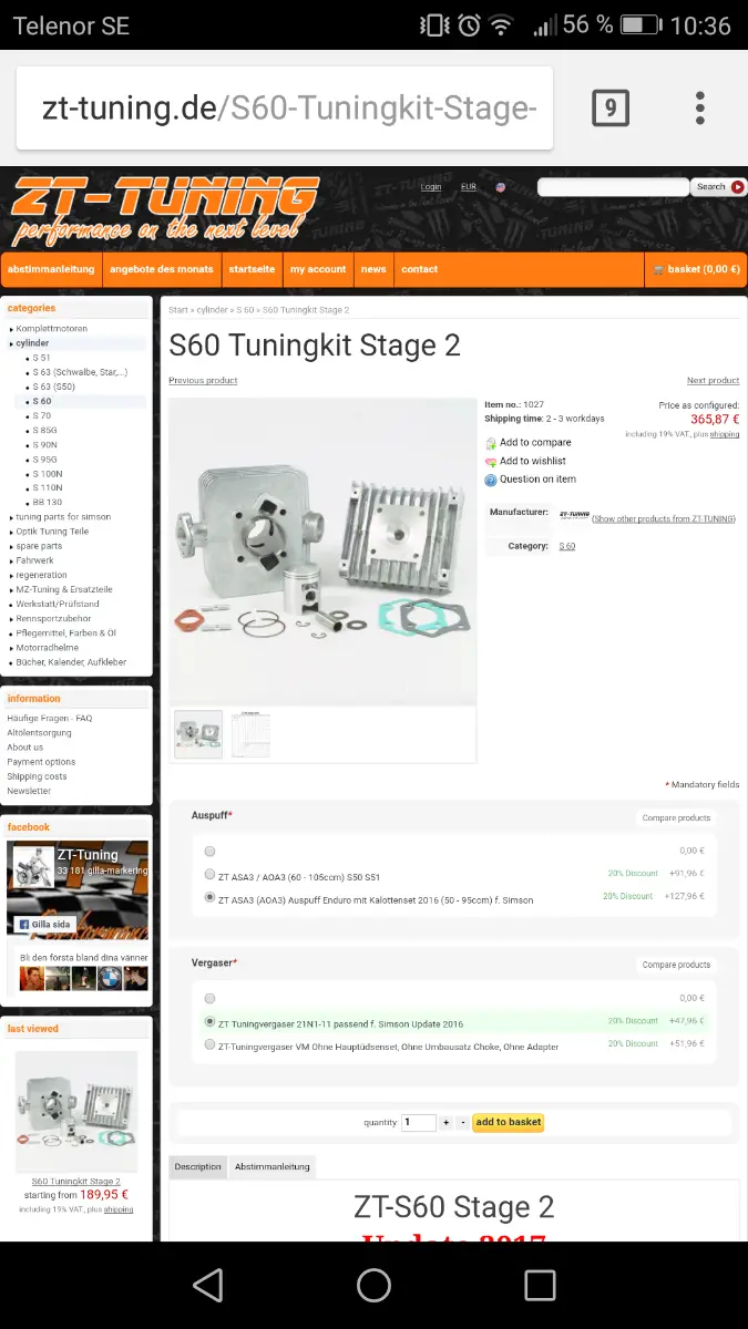

Thank you i want that tuning set but i have a tight budget can you come up with a budget 60cc.kit http://zt-tuning.de/S60-Tuningkit-Stage-1_1
is.that one any good and can i go with the.upgrade set for.the carburetor -
Is this good remember i have a tight budget
:studsa: -
You also need the ZT Airfilter.
http://zt-tuning.de/ZT-Tuningl…filter-Halteblech-gebogen -
What exactly is your budget?
